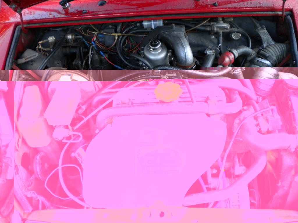

getting a bit bored
seeing all these neat, tidy and very clean engine bays appearing on here, so here's mine.....

Looks fine to me! Why is there a bolt in your boost solenoid outlet? How much boost do you get now? On mine there is a sandstone vent thing on the end so the air can escape.

The stoney thing broke off years ago and I don't think there's any chance of getting a direct replacement. (unless you've got a secret stash somewhere!!)
I still get about 4psi which is enough at the moment as the gearbox/transfer gears sound like they're on their last legs! More whine than all the women I work with,...well almost

If you take the bolt out you'll get your missing 3 psi back! The stone thing is basically the same as the airstones they use in aquariums it's just to keep debris out of the solenoid. Unfortunately I don't have a spare one.

correct the bolt will cause problems, I had a broken fitting on mine they are fragile, I got an airstone as suggested, drilled out the centre, arraldited it onto the fitting, and then coloured it in with a black permanent marker... looked fine.. I was lucky enough to find an original used valve with airstone a couple of years ago.

Your engine bay looks good! Your car does not seem to be fitted with the shortened/adapted heater elbow to take the airflow from the auxilary water radiator out through the inner wing - was it always this way? Mine was missing when I bought the car so I made it, as the factory did, from a standard part - not sure it makes much difference - but with the cooling marginal I figured she could do with all the help she could get!!
I like the updated "Millers Oil Sticker"

The heater elbow duct disappeared years ago, I think it was when I took the engine out to do gearbox no2 (about 1994) I figured on having a bit less clutter in the way under the bonnet and never put it back. I've moved house three times since so it's long gone. As for cooling, it doesn't seem to be affected by its loss, cruising at 70 for half-an-hour or bombing around the lanes in this hot weather and it's quite happy at just under 90 degrees.
