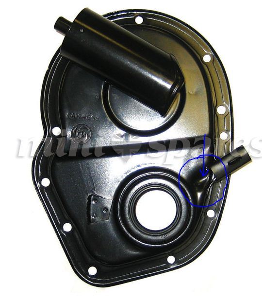

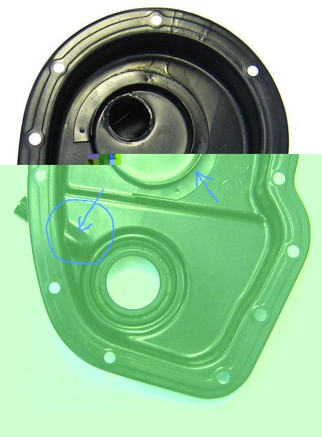

To convert from simplex to duplex you have to modify the timing chain cover.
You have to take out the skirt on the inside of the cover.
And push out the dent.
i hope this will help.
timing cover 1.jpg (106.92 KiB) Viewed 53525 times
