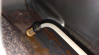

I had a problem recently.
I could get about 3 miles in the car and it would loose power. Switch off and leave for a couple of mins and it would go again and get me home. I installed a pressure gauge in the pipe from the fuel regulator to the carb and duck taped it to my screen. 3 miles down the road and lost power and I could see I had lost fuel pressure. I changed the pump the fuel regulator and a couple of other things. No change. I decided to start at the supply end and took the tank out. I used the idea that Thomas_hmlo used, a hand full of self tappers and a good shake. I got about a heaped teaspoonful of crud out and I also removed the filter off the end of the pick up pipe. Problem solved the car now goes great again. I used a second hand tank for my restoration, I thought it was clean. That teaspoonful of crud was enough to stop the car when it had covered the filter. I don't know if ERA left the filters in the tank or removed them. I have now put a see through filter before the pump so I can keep an eye on it.
It had me beaten for a little while

Hi Prop,
I also recently suffered the same problem from rust in the fuel tank. So I decided to buy a new tank from Minispares and cut out the old pick-up tube and return pipe from the old tank and brazed into the new tank. There is a mesh filter at the end of the pick-up tube but one mesh was broken. I repaired the mesh filter as well as putting a filter before the new Bosch fuel pump. Took it out for test drive. The engine cut out when under boost in 3rd or 4th gear at about 60mph. I also try adjusting the fuel pressure regulator with no success. Any suggestion? Not easy to find a garage with rolling road facility.
Re: Fuel starvation
Hi.
When I cleaned the rust out of the tank I noticed there were large flakes of of oxide that also helped to block the tank filter. This oxide was formed when I braised the return pipe into the tank. It formed as a result of the heat. I suspect it dropped off as it cooled. I removed the tank filter as I thought it would restrict the flow of fuel because the mesh was very fine and if any debris got into the tank would restrict the flow. The tank filter wasn't designed for the massive increase in suction over the original mini pump. The filter I fitted between the tank and the pump was a large 3/8 inlet/outlet like this one
http://www.ebay.co.uk/itm/REUSABLE-WASH ... 35d309786f
My car would perform great up to about 3 miles and then it would loose fuel pressure and it would cut out.
Is that your symptoms?
Are you running standard boost?
I fitted a gunson Lo-Gauge
http://www.frost.co.uk/gunson-lo-gauge-tester.html
teed into the fuel feed pipe after the pressure regulator to the carb. I fed the pipe through the holes in the bonnet and duck taped the gauge to the windscreen so I could see it as I drove. Up to the 3 miles I could see the fuel pressure rise as the boost increased and then the pressure went right down to zero after about 3 miles. (as I mentioned earlier the fuel pump really does suck to produce the pressure for boost)
Switch off and a couple of minutes later (The time for the debris to fall off the filter) start the engine and the pressure was back.
You need to see if it is fuel pressure loss. There could be other fuelling problems causing power loss.
After I fixed the fuel starvation problem I had other problems to fix.
Hope this helps.
Hope this helps.
