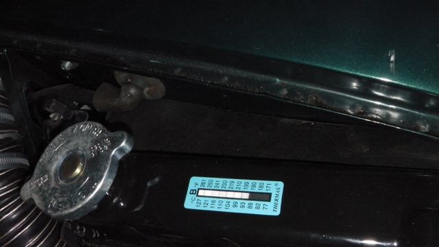

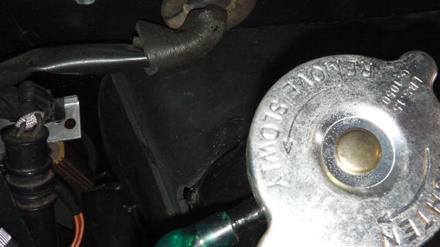

I made one from 150mm x 3mm rubber strip. The trouble is I had to buy 10 metres, which, including vat and postage came to over £50.00. I stuck it together at the rear top edge with super glue. It is also bolted to the rad cowl at the joint so it can't be seen easily.
I tried to track an original one down with no success.
So I made one.
I have no idea if it will stand the test of time, but it fit quite well.
With careful trimming it fits snugly to the inner wing.
Its one of those jobs where the rad comes of and back on so many times it could fit its self!
If you want some of the rubber strip I have left over to make one, PM me and I will arrange to send it to you.

- IMGA0381.JPG (44.37 KiB) Viewed 18574 times
- IMGA0380.JPG (34.74 KiB) Viewed 18574 times
- IMGA0379.JPG (50.08 KiB) Viewed 18574 times

Thank you for your reply and pictures. I have already ordered from eBay for £19.50 including delivery a piece 3mm thick 1metre x 1.4m. I figured that 1.4m should be long enough to form the square. I was going to put the join at the bottom corner so that it does not show. I have also purchased from eBay a set of leather/rubber punches for £5.45!!!!! so that I can get the bolt holes in and apply a radius to some of the cuts!
When I have completed this task I will draw a plan before I install it.
