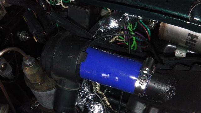

I modified a standard tank.
Because I am running a higher boost I increased the spring pressure on the plenum dump valve by packing behind it and fitted a used dump valve to the plenum from a Saab. The Saab dump valve works well and isn't too noisy.
As I am not too sure if I am going to keep it set up that way I didn't want to spend too much money and I can reverse the mods. I think the Saab valve cost me £10.00 off eBay.
