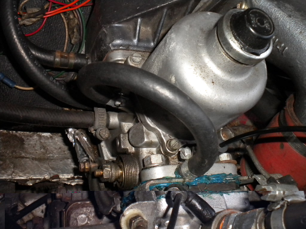

1) Try this....
On the first valve, take off the pipe that goes to the side of the carb and block up with a bolt or similar.
This valve can be a tricky thing, working one minute and not the next so taking it out of the equation will determine whether its ok or not.

Checked the carb rubbings. They are OK.
For the value, my mechanic guy replaced the value by exchange another valve from his ERA. The problem is not going away. I will check the valve tubing. That method is a good suggestion.
