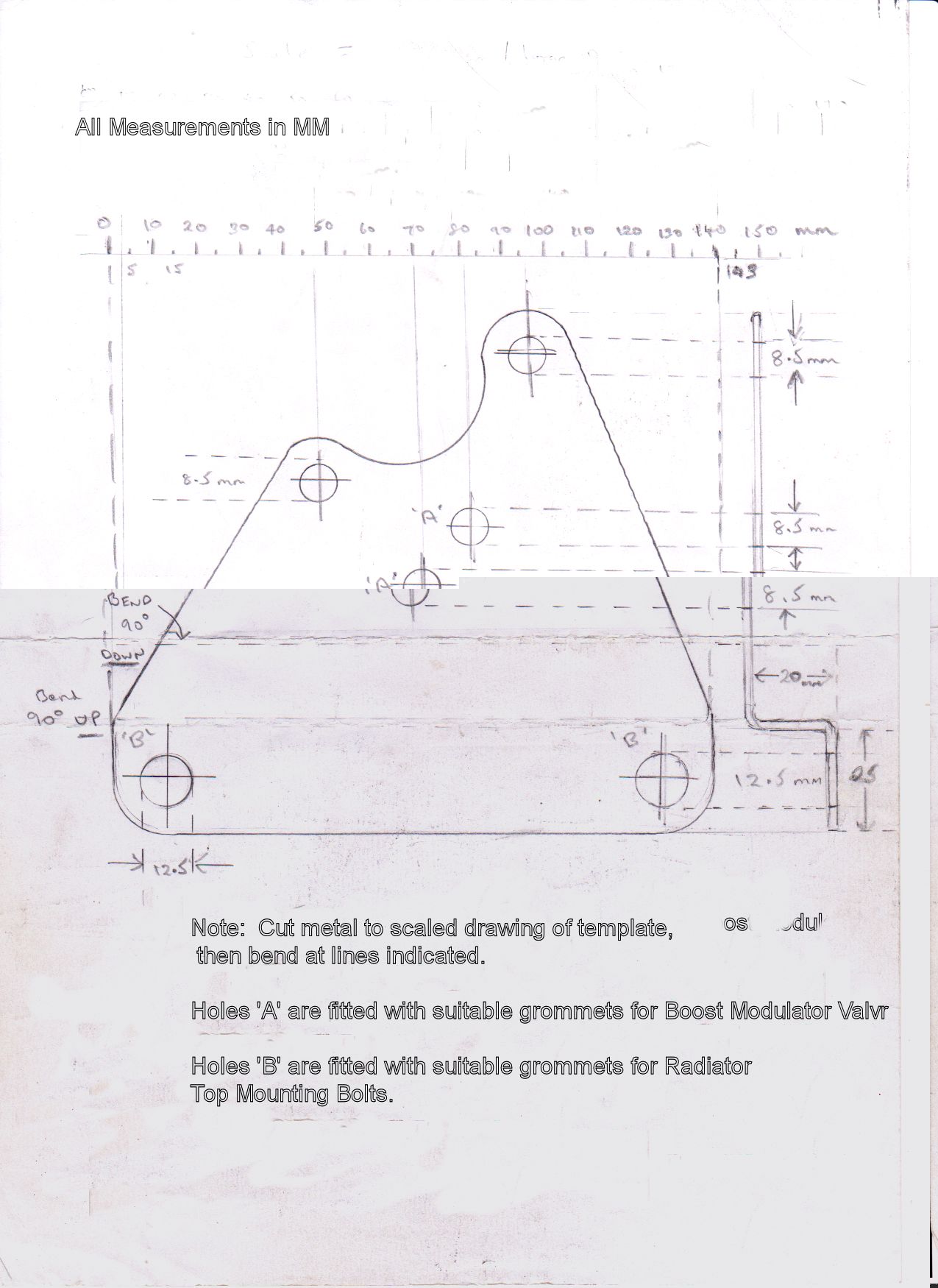

Hi All.
Just found this very rough drawing of Radiator Top Bracket.
I have been intending to tart it up for years but never got around to it.
It was traced from original so if scaled on printer should be all ok to cut. bend positions are critical so note that first bend is 25mm from base of drawing and next bend, the other way is 20mm up from that to give a 20mm deep offset. If you can't read it or have any questions then please e-mail me direct.

Re: ARdiator Bracket
Post by r1076 » Wed Jun 26, 2013 12:33 pm
Thank you very much.

Post by G96LUE » Sat Jul 13, 2013 11:46 am
I made mine starting with a 1275GT top bracket and added the bends & extra holes. I'm sure that is what ERA would have done too :)
