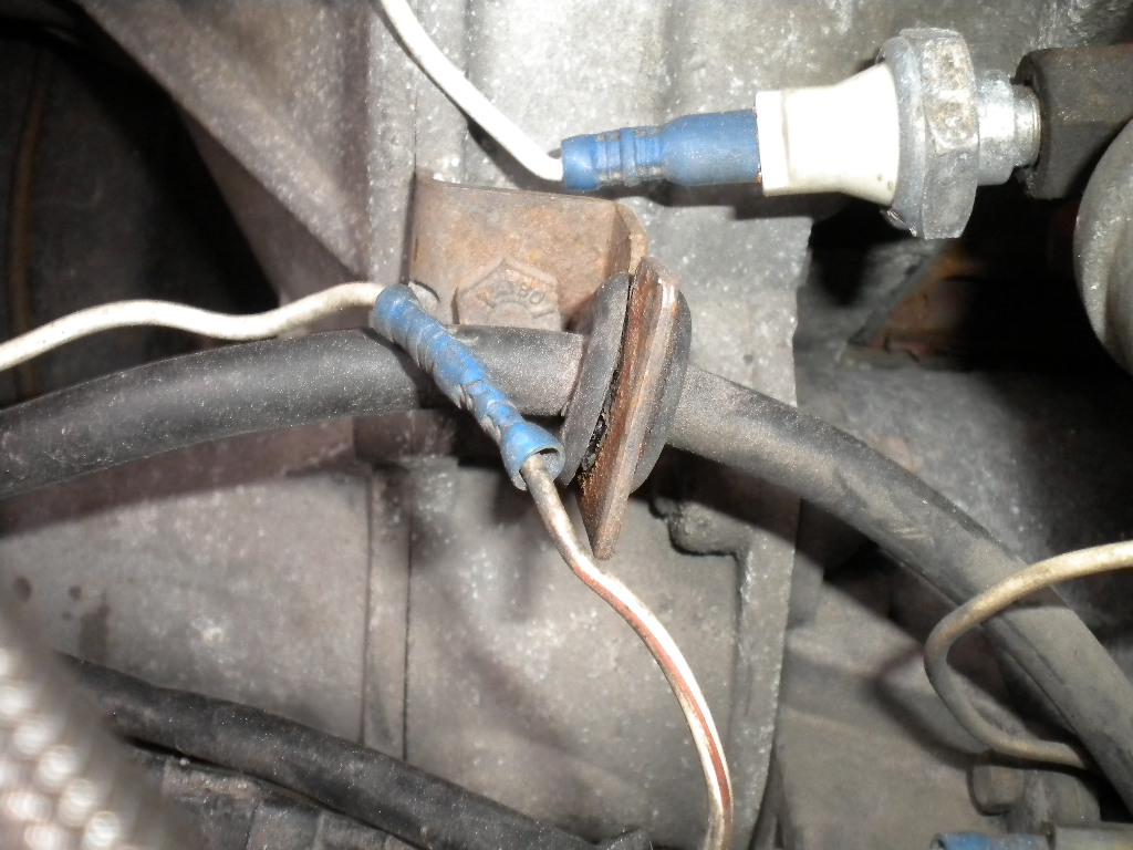

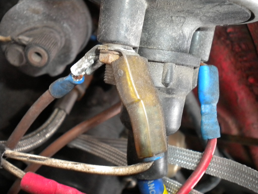

In the 1st, on the coil, there's a white/black and a white (actually red) on the top and the two underneath (which are brown on mine as that was the only wire I had!) which go to the module on the dizzy. Please don't comment on the state of them, I know it does need a bit of a sort out!!!
White/Brown to the oil pressure switch (with a white extension!) in the 2nd pic.
