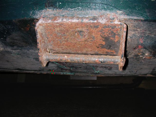

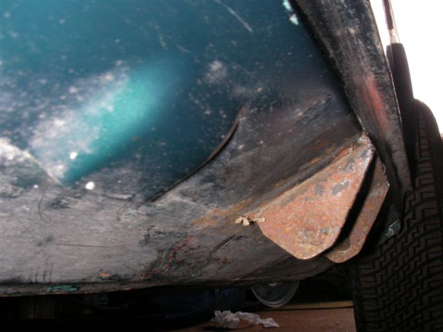

At the last rebuild 9 years ago the jacking points on the sills were removed as there wasn't much left them. Now the sills are being done again I was thinking of reinstating them. I was wondering if anyone had any specs or diagrams of them so I can get new ones made up?

Post by r1076 » Tue Mar 29, 2011 1:36 pm
Hope this will help in any way.
The only two pics I have found at the moment.
Re: Jacking Points
Post by An old original » Tue Mar 29, 2011 7:58 pm
yep, that's good, I can sus out size and position from those..
cheers

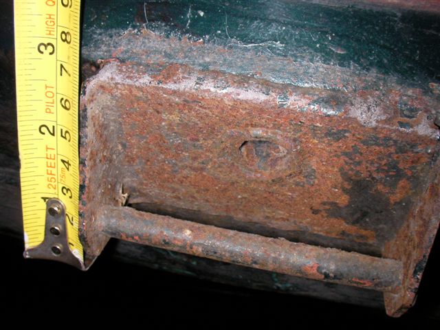

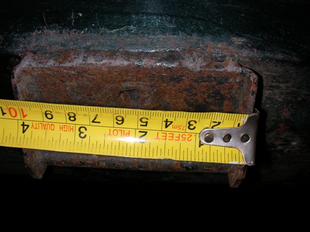

Post by prop » Mon Apr 04, 2011 1:01 pm
Hi, If you need any more info let me know. The metal is 3mm thick
Regards Martin
00001 (3).JPG (68.38 KiB) Viewed 24917 times

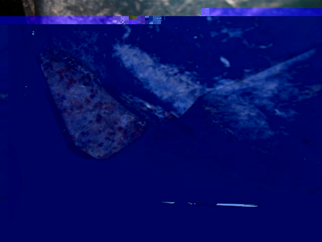

Post by prop » Mon Apr 04, 2011 1:11 pm
A couple more.
There seems to be a tube that runs into the sill. I suspect that it sits in the original jacking point but I cant be sure
Regards Martin
