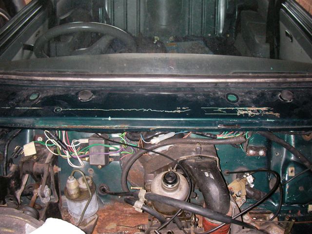

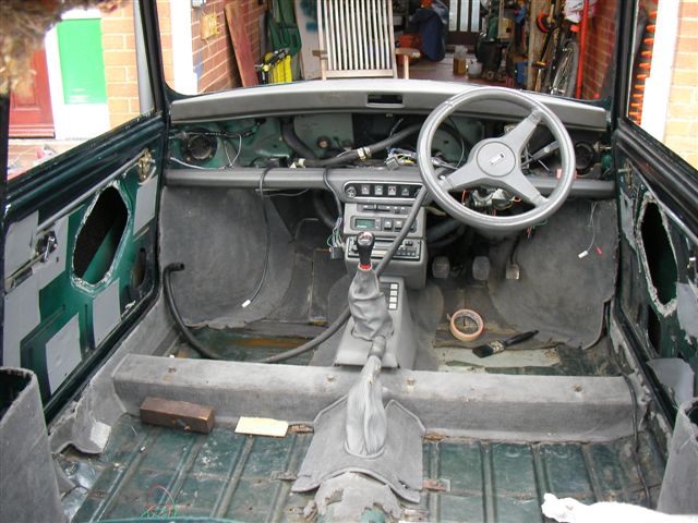

I am starting the slow but sincere job of restoring R1028. A few of you know the appalling condition of this car and the massive amount of work involved. I know I spoke to Darren at Stamford Hall a few years ago. I have left the car untouched since I bought it. I am now stripping it and getting it ready to be looked at by a body shop to get all the dents out of it, but before that I would like to get the gunning gear right. I am not sure exactly what was taken off it before it was recovered so I would like as much information as possible to get right, the kit that should be fitted. I am working on the rear suspension and sub frame at the moment. The sub frame looks pretty new as do the suspension arms and back plates. The car was not on the road that long before it was stolen so the components would look pretty new. When I look at the information about the original work done by ERA, and the changes they were going to make to the original Mini, and then look at the microfiche they didn’t seem to have carried them all out. As the special ERA part numbers are on the microfiche those would be the special order items and all the rest would be standard. (My thoughts anyway)
So. First questions. Were the suspension cones reduced in length to lower the height? The microfiche lists them as a standard part. Was the rear brake cylinder ½” bore? Microfiche quotes an ERA number for car numbers R1001 to 1101. Were the back plates changed in any other way other than drilled for the new position for the dowel? The microfiche refers to information bulletin number ART 44 (March 1992) item No 70. Anybody know?
Any help would be appreciated. This is going to be a long project but well worth while. So as not to give up any secrets to unscrupulous people. We can arrange email or other private contact. I have photos but don't know how to get them on the site.

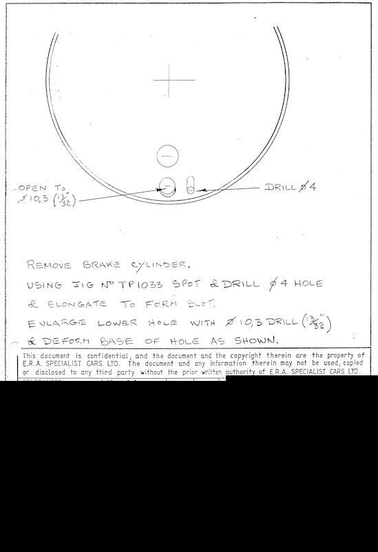

In the rover manual it says the rear cylinders are 0.75" but have a read of this thread from Kayball a year or two back very useful

Thanks for that. Really good information. That seems to sort out the brake cylinders and back plate.

From the pics you've posted it seems you've got some work to do but one thing that's worrying me is that fact you're missing the second cross beam in the cabin. Have you got this or are you going to fabricate a new one and weld it in?

I have attached a drawing of the brake backplate mofification. A jig is called up but I am sure that you can work its exact position. I confirm the details supplied re brake cylinders in my earlier posting.

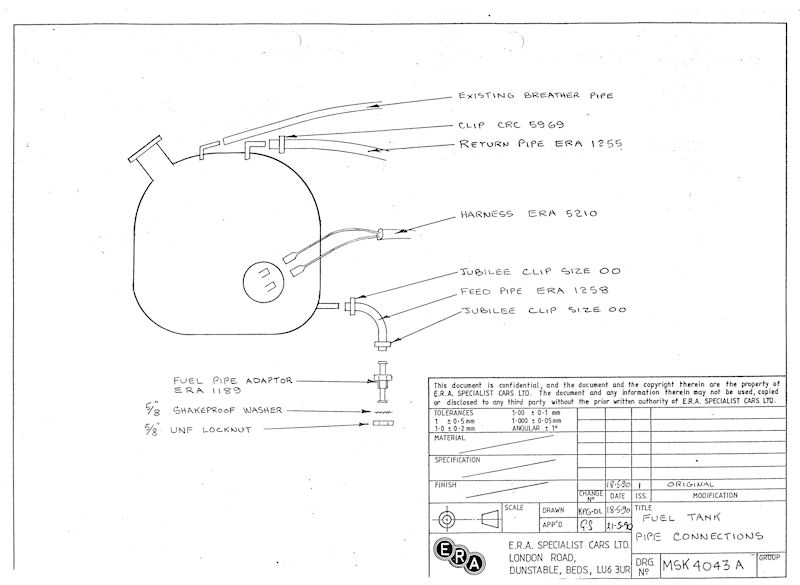

I could do with information about the petrol tank. My car has a tank from an MPI car, with the pump in the tank. I was contemplating getting a new tank and fitting a return but have no idea where it entered the tank ,what bore it was, and where the outlet inside the tank discharged.

I have no drawing pertaining to the fuel tank, as again outsourced, but have attched a drawing of the connections. I suggest you try to see an original tank. Chris tells me that the MPI tank with pump produces too much pressure for turbo regulator as fitted, can anyone comment on this? I dont know if the main fuel feed and return pipes are still fitted to your car, if not then from Fiche they are 37H 7148 and 7150 respectively and are 100 inch (2540mm Long) You should be able to get diameter from this Rover number. Other bits could be copied, again from another ERA. Ask Darren what he did. Is your rear wiper still there? If not, it appears to be a standard front wiper with a different cam cog fitted to reduce the sweep arc. Alternative cam is shown on Fiche.
Hope this helps a bit but sorry I have no additional drawings on this area of car. Best regards
