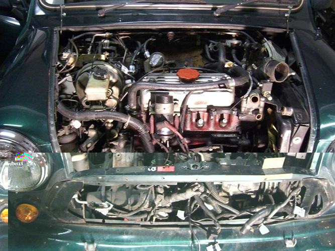

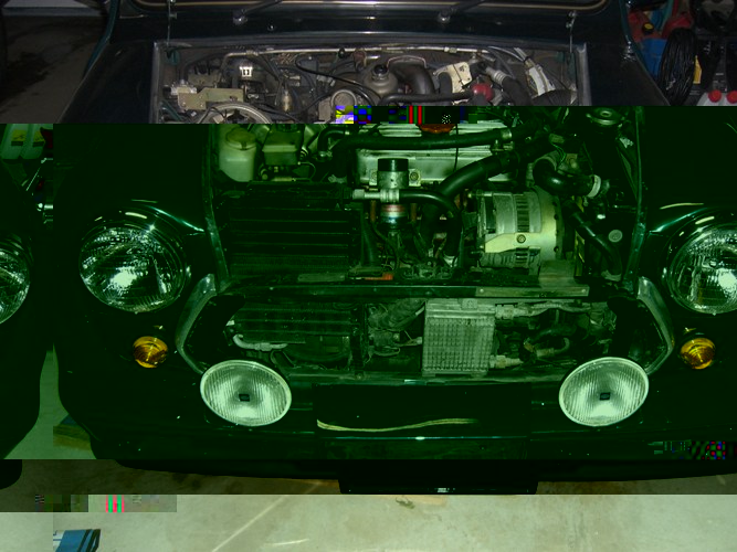

ok, things are finally underway. I brought on some local mini help and they were optimistic that we could have it out in two hours. Well... that didn't happen. We are 3.5 hours in. We have also change the approach and are taking the engine out the bottom. Attached is a picture of the Engine Bay before we started. Then a picture at 3.5 hours. Almost looks like we did nothing.

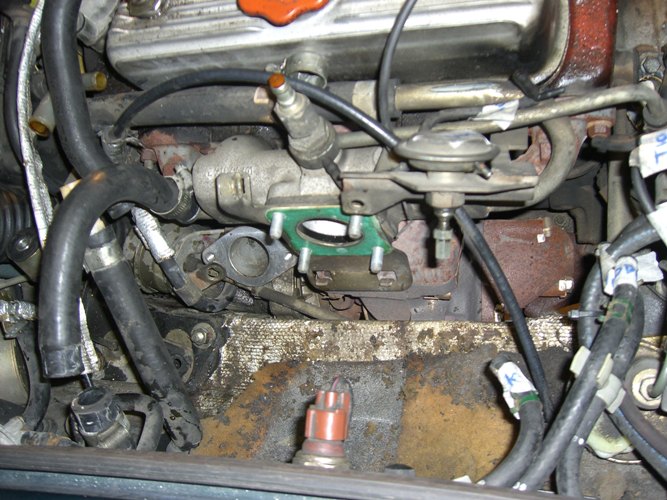

When taking the engine out the bottom do we need to remove the turbo and manifolds? Or the AC pump and the starter? It doesn't look like it is going anywhere with the turbo in there.
Thanks,
Jeremy
Thanks,
Jeremy

From what I remember from late 1996, when I dropped mine out the bottom, once all was diconnected and the exhaust was totally removed, the engine rocked forward enough to take the turbo and manifold out upward before dropping the subframe(and engine).
Just another thought on seeing your photos.. take more as a reference aid for when you have to replace things in the right place later...
