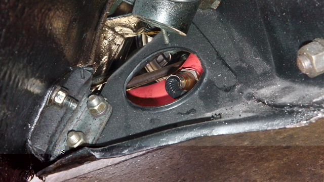

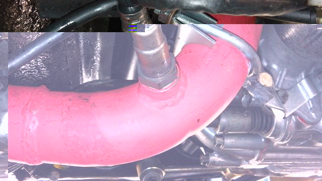

I welded the boss for the sensor into the downpipe at the bend and the tail of the sensor protrudes into the large hole in the rear of the subframe where it mounts to the body. It fits nicely there.

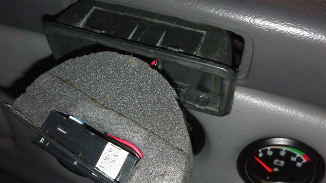

Hi Arrian

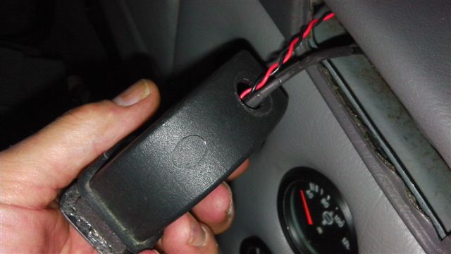

This is the inlet thermometer I used
http://www.ebay.co.uk/itm/AIR-CHARGE-IN ... 1484wt_991
There are cheaper around but they all seem to be 5v and not 12v.

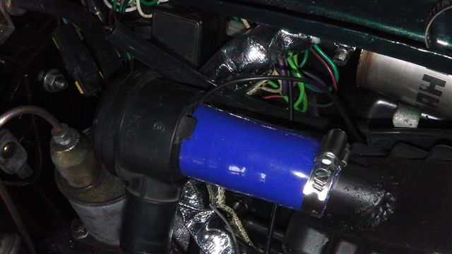

I have mounted the sensor in the plenum through the dump valve connection. I have fabricated a copper wire holder for it as I don't trust that it won’t drop off into the carb inlet.
You could mount the sensor anywhere really to monitor all sorts of areas, external ,under bonnet etc.
There are possibly other gauges that would fit. A green digital display would look good

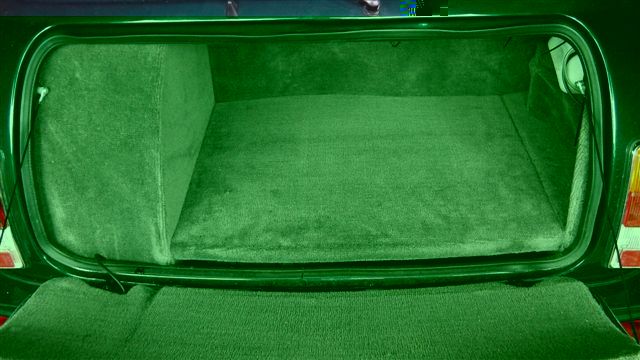

I have finished the boot lining. This went well and I am very pleased with the result. I need to adjust the petrol tank cover as it is causing the carpet to flatten on the boot lid.

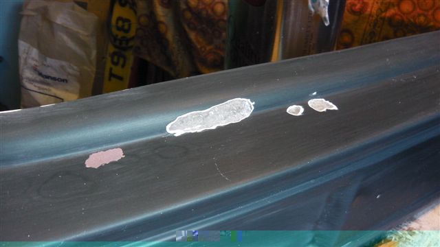

Job complete.
I have refinished the body kit after the appalling job Pool Lane Classics did on it (as they did on rest of the car).
I found there were quite a few voids between the gel coat and the glass fibre. Those I could identify I dug out and filled. I suspect there could be more but I will not be able to discover them until they erupt, if they ever do.
I found I had to spray just two pieces at a time as I don’t have the luxury of a large garage. I found that spraying primer and base-coat no problem at all. The clear coat was pretty hard to do as it is very difficult to see as it is sprayed on. I have sprayed cellulose a few times in the past and the 2K and the acrylic are probably a little easier. The complicated shapes of the body kit don’t make it an easy job to learn clear coat spraying.
Anyway, job done
A local good body shop quoted me £600 to prep and spray the kit. It cost me just under £150 plus my time to do the job.
I am glad I did it myself as I haven’t worked with fiberglass before and it gives you a very good idea of the fragility of the kit. I haven’t done it but I can see there are a lot of places that could probably do with extra fiberglass laying on to give extra strength. I will see what condition it is in at the end of the season before I do any more if needed.
