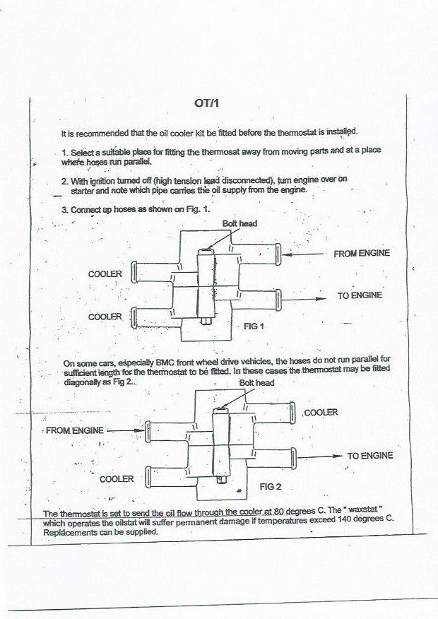

The oil thermostat bypasses the the oil cooler until the oil reaches the temperature of 80 degrees so the oil flow from the engine to the filter and back into the engine is not interrupted. The whole of the oil system is kept under pressure as normal. All the thermostat does is divert the oil flow through the cooler when the oil reaches 80 degrees. One would hope that Mocal who produce the thermostat and oil coolers know what they are doing with oil systems. As I have stated this is an experiment and I will report my findings when I put the car back on the road. Hopefully I won't melt the bottom end

Took the car out today. I now have the thermostat fitted and I have a temperature gauge fitted to the sump. It was a good hot day today the sump oil gauge showed the oil temperature rising, the original gauge showed no movement. The thermostat obviously working. As the temperature in the sump rose to about 80 degrees the temperature of the oil cooler started to rise reducing the temperature in the sump, I would assume as the thermostat is working, on a cooler day the oil would circulate longer within the engine before needing to be cooled, therefore heating up quicker which is the effect I am trying to attain. At the moment I am happy with how it is working. I will continue to update as I use the car through the season. I have also reinstated the auxiliary radiator for this season. The water temperature while out today stayed around the 80 degrees level which is probably correct as the coolant thermostat is 88 degrees. I would like it if it had reached nearer 90 degrees I will live with it this season as if I get stuck in traffic I want as much cooling as possible.
Fitting the thermostat is an experiment to see if it is a worthwhile addition for the ERA and also to give information and how I tackled the job.
