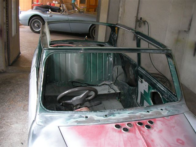

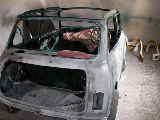

I took the car to the body shop http://www.poollaneclassics.co.uk/ on Friday 24th June. Mark, my contact there thought it wouldn't cause them too much trouble to get back into pristine condition. The biggest problem I think is the body kit. The rubber seal is the stumbling block as the other thread on the forum is showing. I hope to have a few photos of the progress at the body shop to post shortly.
I went to the body shop today to take a couple of parts in and to check on progress. A couple of photos attached. Note the very nice Austin Healy 3000 in the background.
- SANY0061.JPG (57.29 KiB) Viewed 138472 times
- SANY0058.JPG (59.78 KiB) Viewed 138472 times
Looks like good progress so far
