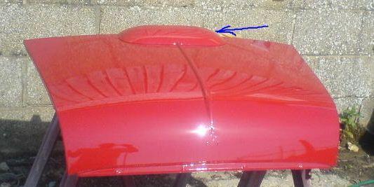

I'am looking for a era bonnet scoop like in the picture.
Does anyone have a spare,or knows where i can find one?

When I restored 1089 I had a boat builder take a mould of the bonnet scoop and the 4 piece body kit. It would seem that it is possible to obtain replica Japanese spec 5 piece body kits but I drew a complete blank trying to find any British spec 4 piece kits. I used one of the copy bonnet scoops on my car and it fits perfectly.
I decided to bond 4 x M5 inserts into my new scoop and screw it to the bonnet. It would appear that originally on this car it was attached by double sided tape.
I am waiting for the first complete body kit to be fitted to a car to check the fit.

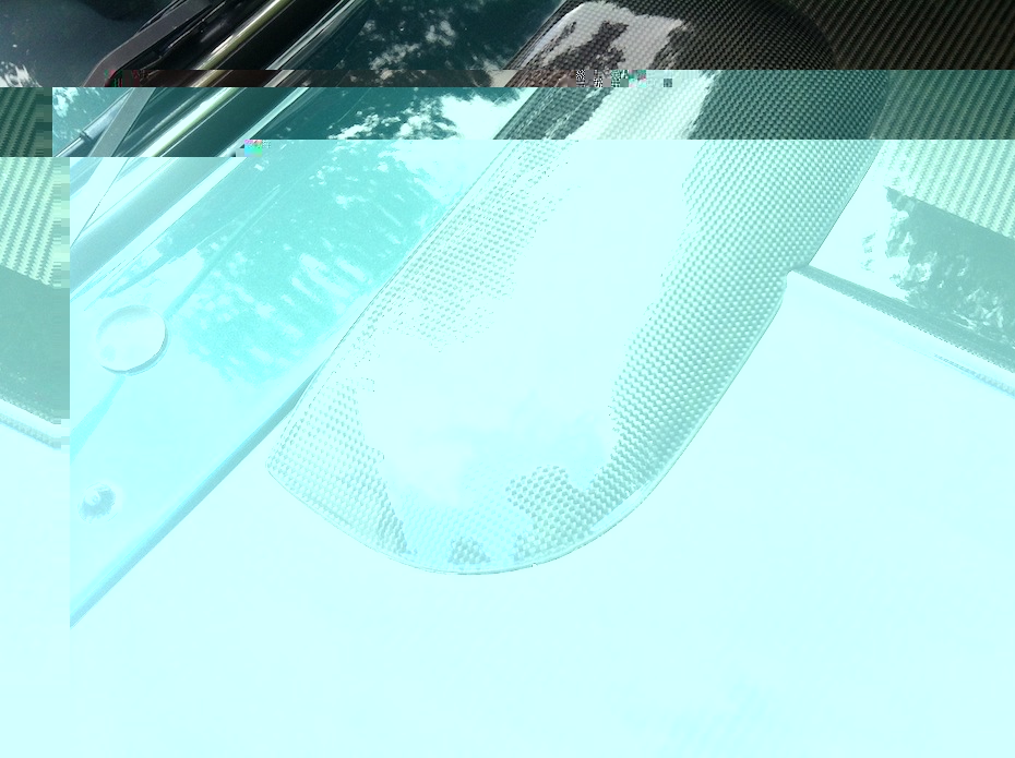

I got one of the cheap ones offered on e-bay sometimes and took a mould to make a better one.
I could do more in Fibreglass, but not this Year. I made my new one without any flange and glued it in place with windshield glue.
