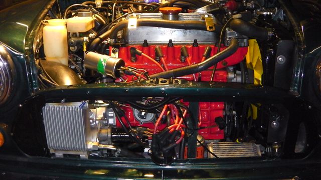

I made mine out of a Mocal oil cooler 16 row 115mm ½ bsp male connections. The original mounting lugs are cut off and new mountings welded to the rad sides. As you can see in era1097s photos the Mocal rad is identical to the original one.
This is my new aux rad fitted. It went very well.
The problem I have found is that at the moment it seems to be overcooling. I fitted a new rad minispares 4 core C-ARA4444B. This better cooling rad was not around when ERA was building the cars. I think it is too much. I need to experiment a little. Perhaps fit a thermostatic valve in the oil cooler system.
