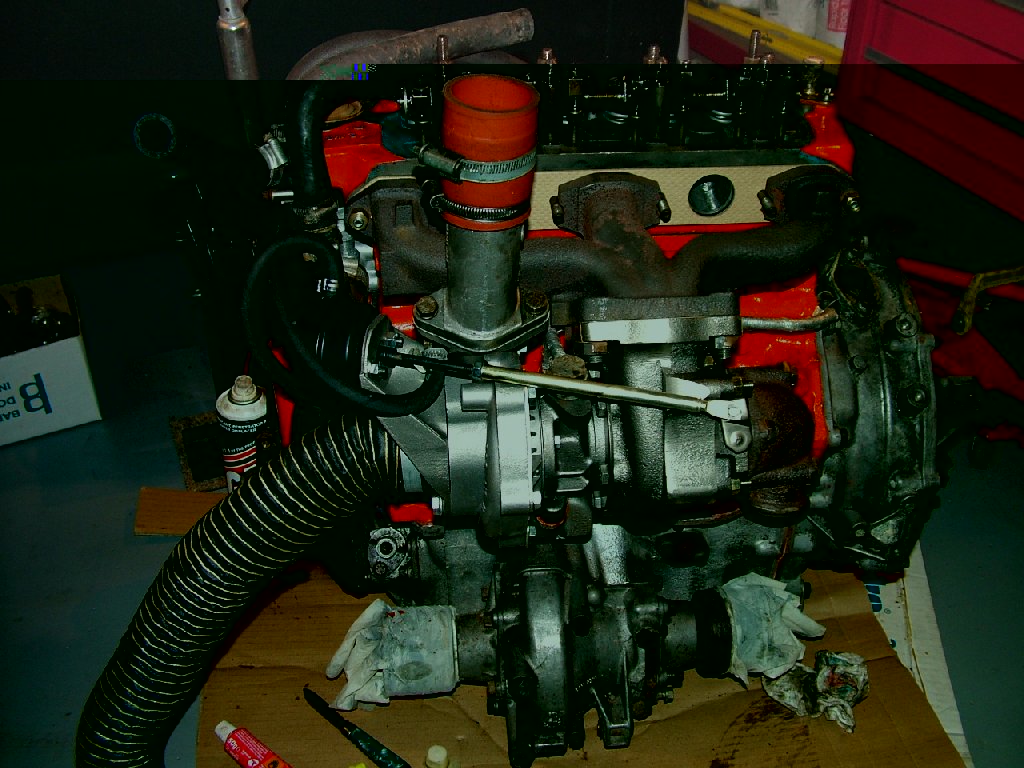

I've just fitted a new steering rack and a new turbo too.
I hope when mine has been tuned again it will be ok.
Here is a pic of my new turbo. It all went back together last Sat and it doesnt smoke anymore :D
My New Turbo.jpg (190.1 KiB) Viewed 21920 times
