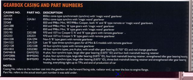

wich is the original ERA gearbox??
Is it DAM5626, Dam4818 or DAM2886 ??

from the Microfiche, page E05, my interpretation is that the complete gearbox is " BHM 5161 Transmission Assembly 3.21 final drive." but the casing is BHM 5093 illustrated at E04. Were did you get the DAM numbers?
Re: Gearbox Casting Number
Post by paul » Wed Feb 08, 2012 3:56 pm
DAM ???? is the number cast on the side of the casing, not the part number applicable to a built unit.

The DAM may possibly be the foundry identification number.
.The foundry normaly put there own part number for there reference and identification as well as the casting number.?

I have this copy from a magazine article.
I hope you can read it.
I believe the The A+ 3 bolt main shaft bearing retainer was adopted because the 4 bolt tended to crack with the extra power on the turbo metro cars.
Hope it helps.

Post by r1076 » Sat Feb 18, 2012 4:50 pm
Thank you.
Than it is DAM 5626.
