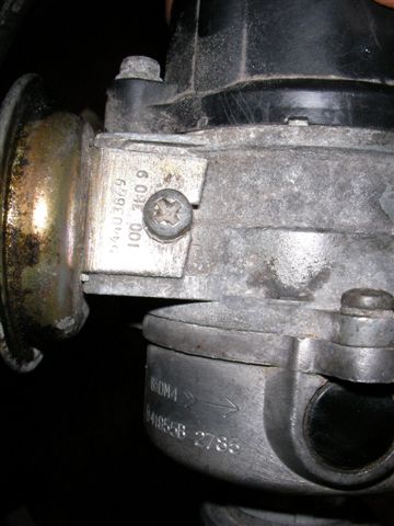

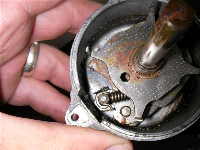

Post by An old original » Fri Sep 23, 2011 3:53 pm
These pics are the best I can manage without taking bits off
The numbers to the left of the 2003 on the body are 1533, confirming the type as in my original post (I presume!)
