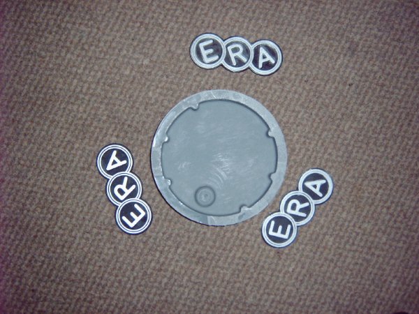

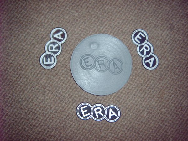

just a few pictures as whats been done so far i think the badges need more attention on the silver as this is awkward to get to look nice any ideas . the one badge is genuine
the center cap is made from aluminum resin, the diameter has been adjusted as well as the depth to suit the other wheels they just need the hole drilling and painting have a look see what you think

Hi Dean.
these are looking pretty good so far.
not sure about the best painting method though on the badges.i suspect the originals were run over some sort of paint roller.
one thing you could try is put some bluetack on the back to act as a handle.
sprey some silver paint onto a sheet of plastic which is on a flat surface (maybe put a news paper under it to give it a little flex) then press the badge onto it and then remove to dry.
might be worth a go.
i will wait to see how you get on.
All the best

hi darren.
i think your probably right iam using paint maybe too runny i will get some spray and have another go i suppose practise makes perfect .
i think your idea with the 3 d plastic printer would get a better job but as iam experiencing its down to cost with so little numbers required
i think that's why nobody bothers reproducing parts for the ERA .
i will keep trying till i get ther all the best dean.

have brought a 5kg tin of resin 5kg tin hardener and 25kg bucket 0f aluminium powder i have taken resin moulds of my originals and done a few mock ups as you can see i can get aluminium castings of these but foundries want a minimum order eg to set a die to cast the wheels they quote £500 before any casts have been made
i do believe if you can get originals they are far the best but if you cant as you and others probably know the way iam doing it, i thing is probably the most economical way. if you want me to get you some badges i will cast some blanks so you can have a go at painting them yourself if you prefer let me know and i will cast some for you all i ask is just to cover the cost of materials

Looks like a good solution, I bought a reproduction of Ebay a couple of years ago which looked the business but didnt flex so would be good for a front one but not a rear which needs a little flex. I let it go with the Red one to Ireland last year.
Talking of which they say they are bringing it to IMM this year so will contact them and ask them to join the group.
one way would be to cast the badges so they are silver and then spray them satin black and then buff them on glass sheet wrapped in cloth dosed up with t cut and will cut through the satin on the raised bits..

hi paul thanks for the respond will try that
l don't mind casting some resin blanks off just to recover cost of material as-long as you can paint them as iam not happy with the result yet cheers dean

hi paul tried your idea today it worked a treat thanks for that owe you one there
i will send pics later as iam of out. plus out of interest if you don't mind being honest how much did you pay for the last badge you brought as i just need to cover the costs iam not out to make a profit just fair on both sides just an idea ile send a pic later cheers dean.
