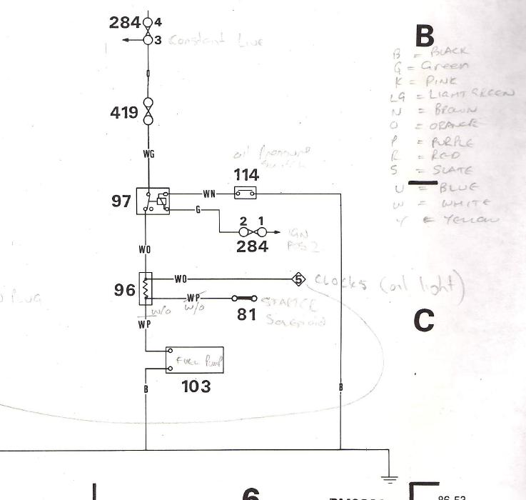

Jeremy, do you have a copy of the wiring diagram for the ERA?
If not, let me know and i will scan a copy for you and mail it to you.
The fuel pump is protected by two fuses. One is in the main fuse box and comes from terminal No3. The other is an inline fuse that has a white wire with green tracer going to the relay.
This is the power feed to the pump.
The Relay is powered via a green wire that comes from terminal No2 on the main fuse box. This is powered by the ignition switch and is earthed via the oil pressure switch (you havent replaced this have you as there are two types?)
power from the relay goes our on a white/orange wire and into the resistor bolted to the servo.
It then leaves the resistor in a white/purple wire (or white/orange) and heads towards the fuel pump. Positive feed at the fuel pump should be the white/purple wire.
Check it at the resistor when you crank the car (check both in and out terminals). As you crank they should both show power.
Power to the side that goes off to the pump is also supplied by a wire that comes directly off the starter solenoid. It might be worth dropping the grill off and making sure there is a good connection on the white/orange wire there.
I hope this helps.

Re: ERA Refusing to start??
Hi Jeremy,
Here is a scan of my wiring diagram.
I hope this helps
I hope this helps
