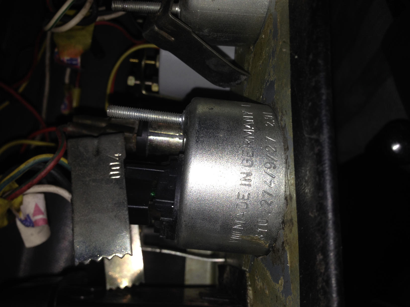

Post by arrian » Tue Mar 20, 2018 8:55 pm
My gauge has this number on it: 310.274/9/27 2.91 (I think the last bit might be the date of manufacture). I'll add a photo when I get home.
Re: oil temperature sender
Post by arrian » Wed Mar 21, 2018 8:40 am
And a pic of the gauge, I also added the number on it to the facebook chat about oil temperature too.
