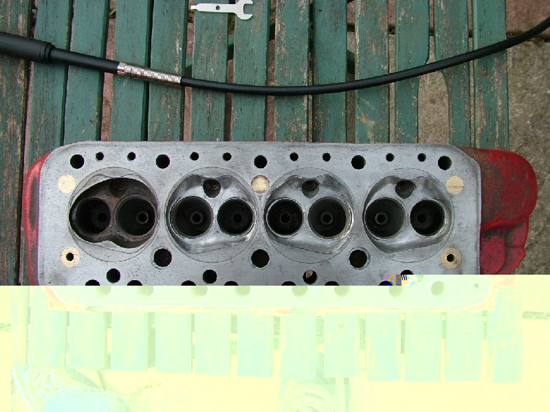

Its been very quiet here for a while now so i thought it was about time i did something about it, so here is my latest project.
As you have probably seen from my previous postings, i had to build a new engine for my motor last year. It has now been run in and needs tuning, however i am now thinking of adding a little more power.
i picked up a head of ebay for £34 and have decied to mod it myself.

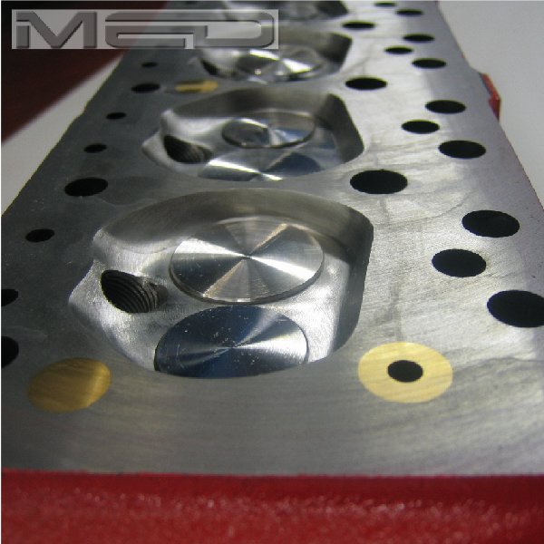

i have used the photo on the MED website for the profile, and am using Dave Visards "tuning BL's A series engine" for port profiles.
i am hoping i can increase the boost a little.

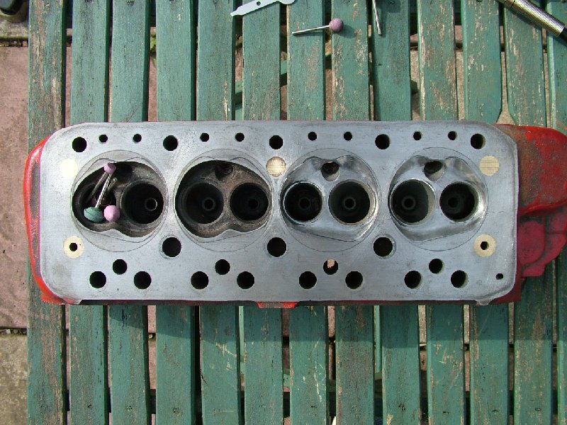

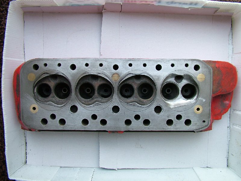

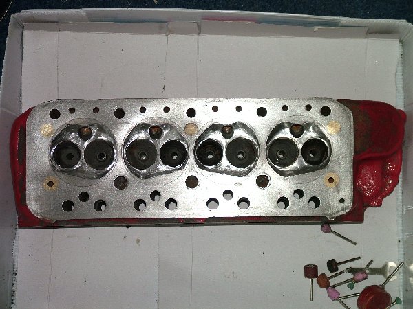

As you can see from the following photo's, there has been a lot of metal removal.
Hope to see some of you soon.
Darren :)
This is my intended profile

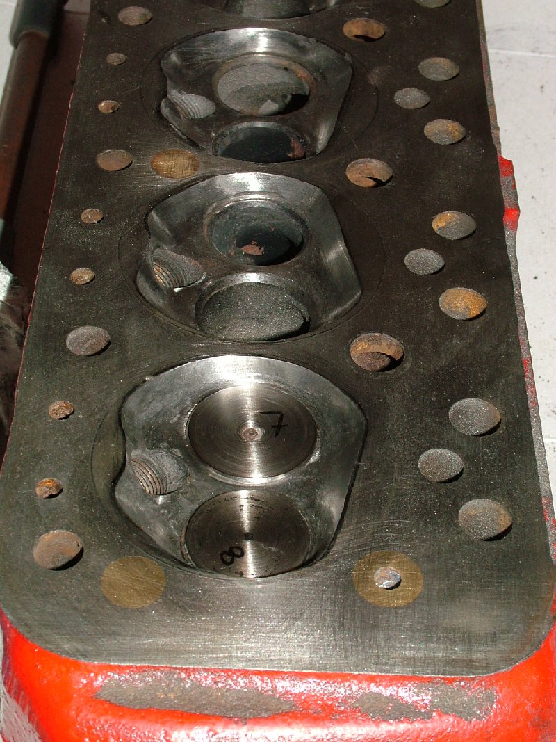

Re: MORE POWER
Post by G96LUE » Sat May 03, 2008 8:16 pm

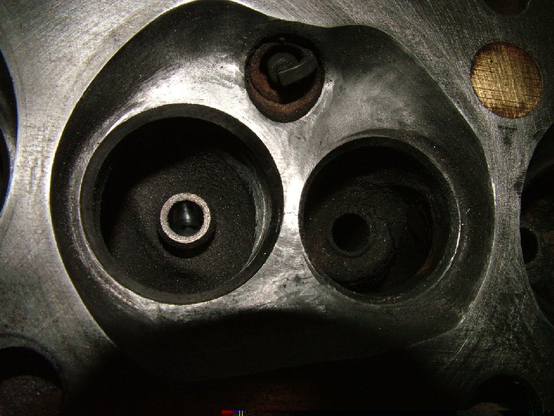

chambers 1 & 2 and an MED angle shot

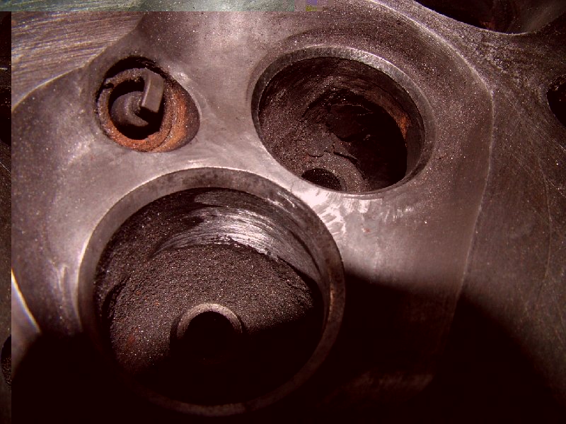

Post by G96LUE » Wed May 07, 2008 7:29 pm
:cry:

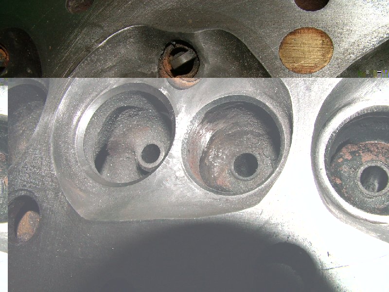

bad news. After all the work to the chambers, i stared to look a the ports.
unfortunately i found a crack between the inlet & exhaust valve on cylinder 3.
Well it was good practice i suppose.
it looks like it will have to have a rolling road with a standard head for now. :(
